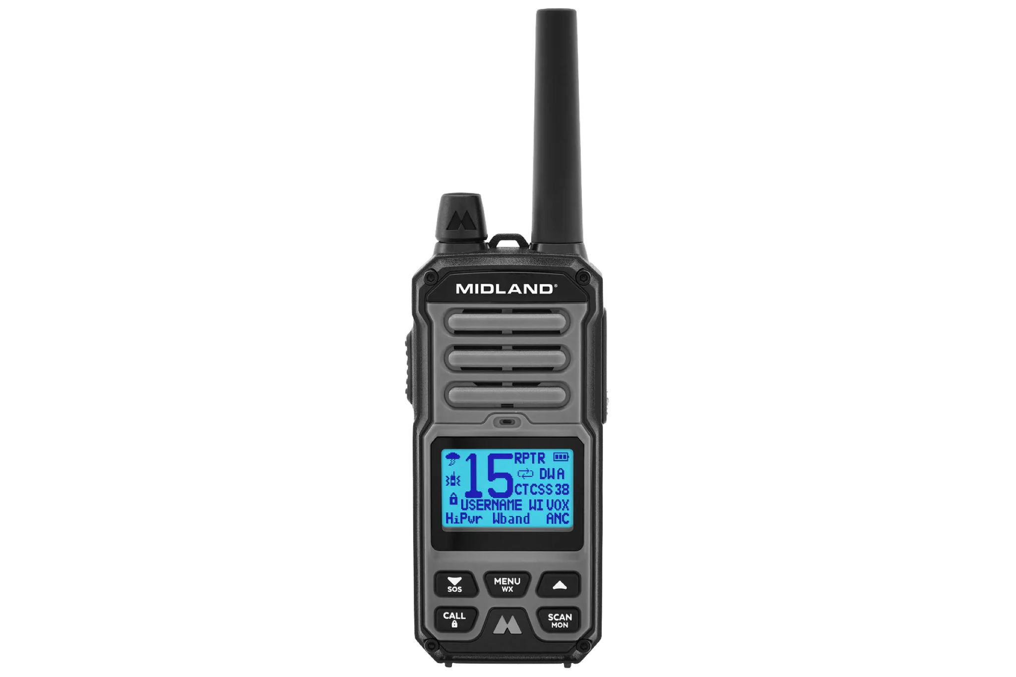

The Midland GXT67 Pro is easily the best handheld in the brand's lineup; (photo/Nick Belcaster)
"How about now?" 15 miles is a long distance for most walkie-talkies, but my voice was still coming in clear, transmitting from the Midland GXT67 Pro. Granted, this radio isn't just any walkie-talkie, but a repeater-capable GMRS unit, and by leveraging a little radio know-how, it was booming over the heads of lesser handhelds.
The GXT67 Pro is the top of the line from the brand, and finally adds the ability to use repeaters — basically, remote signal amplifiers — which can greatly extend your range. Besides that, Midland gave the radio the full treatment, making it fully waterproof, boasting a long battery life, and giving it a user interface that doesn’t require a manual to figure out.
I folded the GXT67 into my everyday communication needs for a month and took it everywhere, from truck camping to whitewater paddling trips and scouting recent wildfire burns looking for morel mushrooms. Here’s what I learned about this little powerhouse communicator.
In short: The new Midland GXT67 Pro is likely the best handheld radio the brand has ever made. Despite some room for improvement, it makes a compelling case for getting a simple GMRS license and really leveraging these little radios’ power.

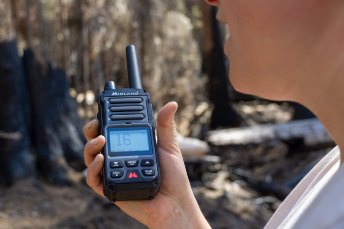

When I've previously used GMRS radios from Midland (the GXT1000VP4), I was dismayed to see that while those handhelds hosted the full 5W power output that GMRS radios can sport, the radios weren't repeater-capable. No longer on the GXT67 Pro — this radio is repeater-ready.
A repeater is best thought of as a remote amplifier station, picking up your signal and boosting it with more transmission power to get your voice out to a much wider audience. Radio nerds across the country (and indeed the world) have set up and operate these stations, sometimes for public use, and sometimes for private.
The GXT67 Pro is Midland’s first handheld to access this functionality, and it does so excellently. To test this, I keyed up the local GMRS repeater, which corresponded to channel 23 on the radio. I was about 3 miles from the antenna, which is mounted atop a 500-foot hill here in town.
Three miles was no problem getting into the repeater, and even after moving out to 15 miles, I could still get my signal in enough to be able to have it picked up by my partner on the other side of town. A good showing for the GXT67.
