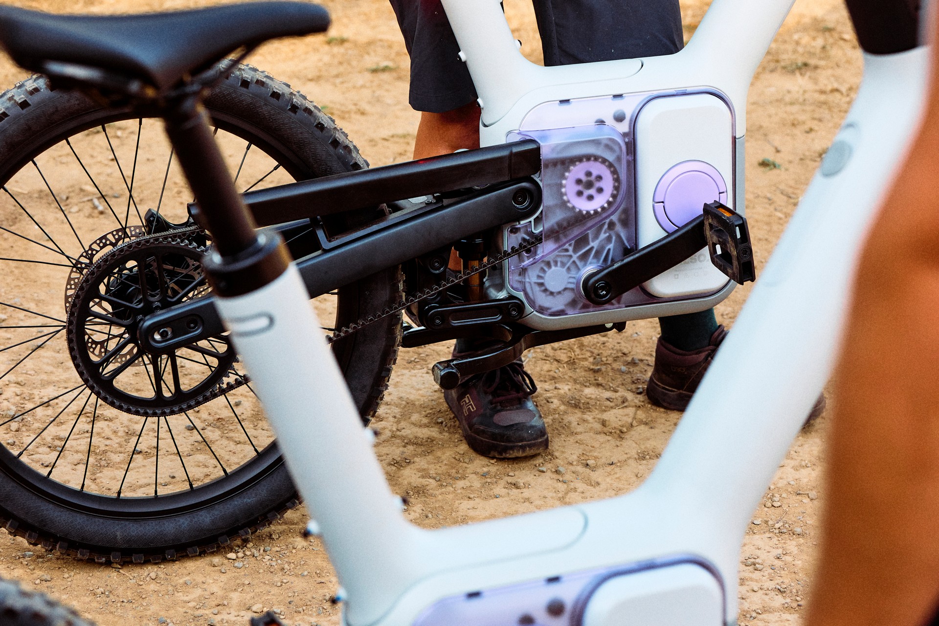

Also’s biggest feature is its DreamRide drive setup. With most e-bikes, you get a motor either in the rear hub or attached to the bottom bracket and driving the crank. Either way, there is a mechanical connection between your foot on the pedal and the rear wheel.
The DreamRide system removes that connection. It still has pedals, but instead of spinning gears and then tires, they turn a generator and send power to the battery. All drive comes from the motor, which, Also says, makes the ride smoother. Think of it like an extended-range EV, where the engine (in this case, you) spins at an efficient speed and load to save energy.
Two modes called “transmission styles” make it sound even more EREV-like. The first is called Auto, which lets you pick a cadence and stick with it. Motor output and generator input will adapt to help you hold that pedal speed. The second is called Manual, which uses software to create gears and feels more like a regular multi-speed bike. The rear wheel is belt-driven, with a Gates drive system and 62-tooth rear sprocket.
